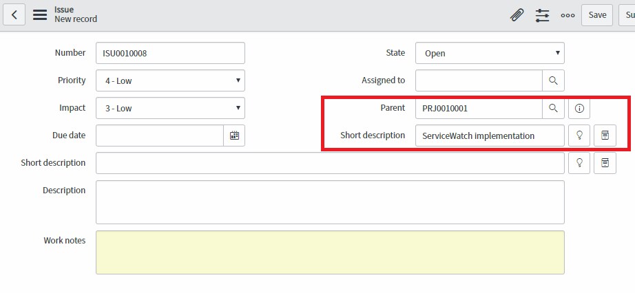

This will cause the display value of Issues to be the short_description.
But it sounds like you want the Task's short description when you reference a Task from Issue. I could be misunderstanding you though.
If I AM understanding you correctly, you can't pull this off with an Override (unless you want all Task references to work that way all the time). You're way better off just dot walking up to get the task.short_description on whatever field / list view you're looking at.

Problem is, if you override the display column to be short_description on project, that will be true EVERYWHERE, not just in your Issue context.
On the form layout for issue, you should be able to select the Issue's Project's Short Description as a field, instead of the bare reference.
When the field selector page refreshes you'll be looking at fields from the parent record. Pick short description

My first thought would be that you are doing a dictionary override on the short_description field and since its value and display value are the same doing an override on display value does nothing for you. You have to do the dictionary override on the your reference field. Setting override on display value does not see to allow you to choose another column so I'm not sure what it would do of if what you are looking for is possible.
