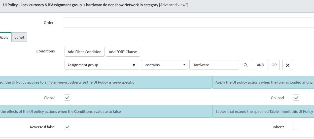

Try a UI policy. Change according to your requirements.

This does not seem to work. Please help.
Hello vkachineni,
Yes this worked but with little adjustments as below :
 g_form.addOption(<fieldName>, <choiceValue>, <choiceLabel>, <targetIndex>);
//‘targetIndex’ is an optional parameter.
Thank you so much for your help.
