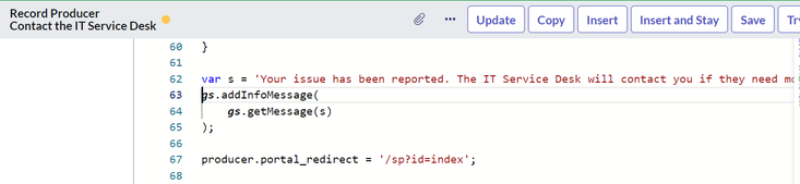

Well, I figured it out shortly after I posted my last reply.
In the record producer script, I updated this:
var s = 'Your issue has been reported. The IT Service Desk will contact you if they need more information. Thank you!';
gs.addInfoMessage(s);
to this:
gs.addInfoMessage(
gs.getMessage(s)
Screenshot:
I hope this helps!
