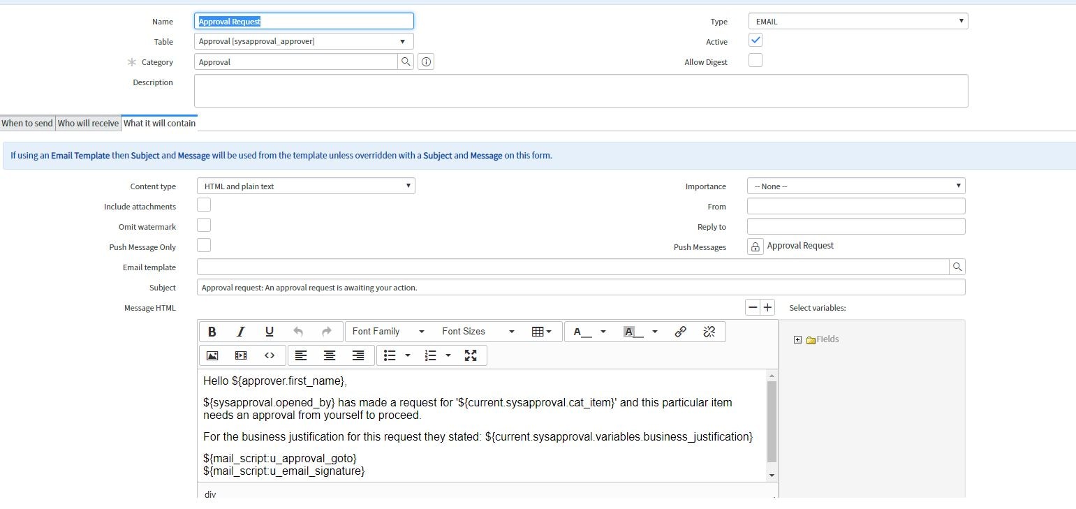

I am working on updating the approval request email notification that goes out to the relevant approver. This particular version is used for Service Catalogue items.
I am currently unable to dot walk from the [sysapproval_approver] table to get the name of the person the catalogue item has been ordered on behalf of. I can easily get who opened the request, but I need the name of the user in the 'Request For' part of the request.
This is currently causing an issue where approvers are being asked to approve requests for the person who opens the ticket, and not who the item is for.
Can anyone please assist?
Thanks in advance

Thanks Prateek! Whilst that works, I adapted your answer to add it within the notification itself, without the need for the email script.
${sysapproval.request.requested_for}
This worked like a charm. Thank you for you help 🙂
