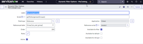

Here is the Dynamic Filter
Note that I have tried with and without a Reference script and that there was no difference to the behaviour

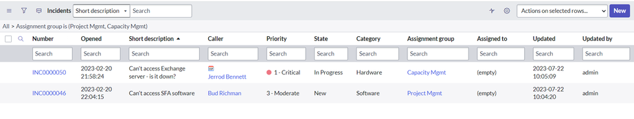

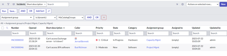

When I use the Dynamic Filter, from the incident list of records,
This is what the filter shows when you run it
And here is the log in the incident description
As you can see, the Dynamic Filter does not seem to be able to deal with a “CONTAINS” clause or something else altogether different is happening.
