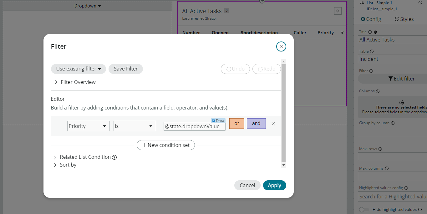

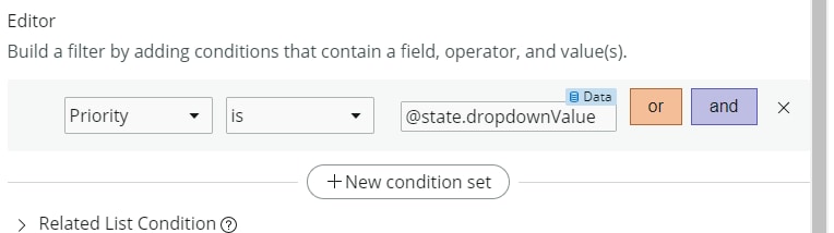

Hi Cooper,
Bind the filter value through dynamic binding to the value of the drop down selected as below:
In below case i have populated Incident table in LIST and priority in drop down
a) From drop down events "Dropdown item clicked" call the client script to update the newly created Client State Parameter as follows:
Client tate Parameter:
b) In the client script update the CSP from the drop down item value.
Mark this helpful/correct if it works for you.
Cheers,
Anu
01-13-2022 03:32 PM
Hi Anu, thank you for your response! Where are you building that filter that you can data-bind the value like that? On my list I dont have the ability to select a column to filter on and I also dont see it in the "filter" component.
