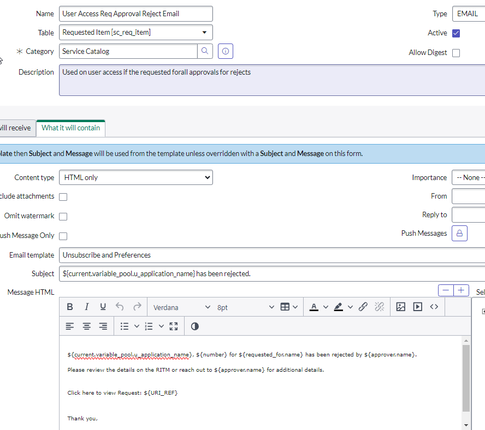

I am trying to create a notification that will be triggered from a flow.  The approvals on the flows are being pulled from the request access applications table.  I want to use the same notification on a lot of flows.
How do I get the Approver’s name into the notification.  I don’t want this to have links to approve or reject.  Its strictly a notification saying the item was rejected.
In my example below, has been rejected by Abe Lincoln.
Please review the details reach out to Abe Lincoln.
I can not get that name to populate into my notification.
Any assistance would be greatly appreciated.
Hi @darlene You can copy this notification and add condition to check for your catalog item(see screenshot) and remove links from new notification. Additionally add is NOT = "your catalog item name
" condition under existing notification to avoid duplicate notifications.
Anantha Gowrara
@Darlene York Just curious, why don't you make use of OOTB rejection notification on approval table? Is there any specific reason why you want notification on RITM table?
@Anantha Gowrara  the OOB one has links on it to approve or reject.  I dont want the links.  Unless there is another notification that I'm not aware of.  If there is something oob, I guess there is no reason to reinvent the wheel.
Thank you.  I will try that!
