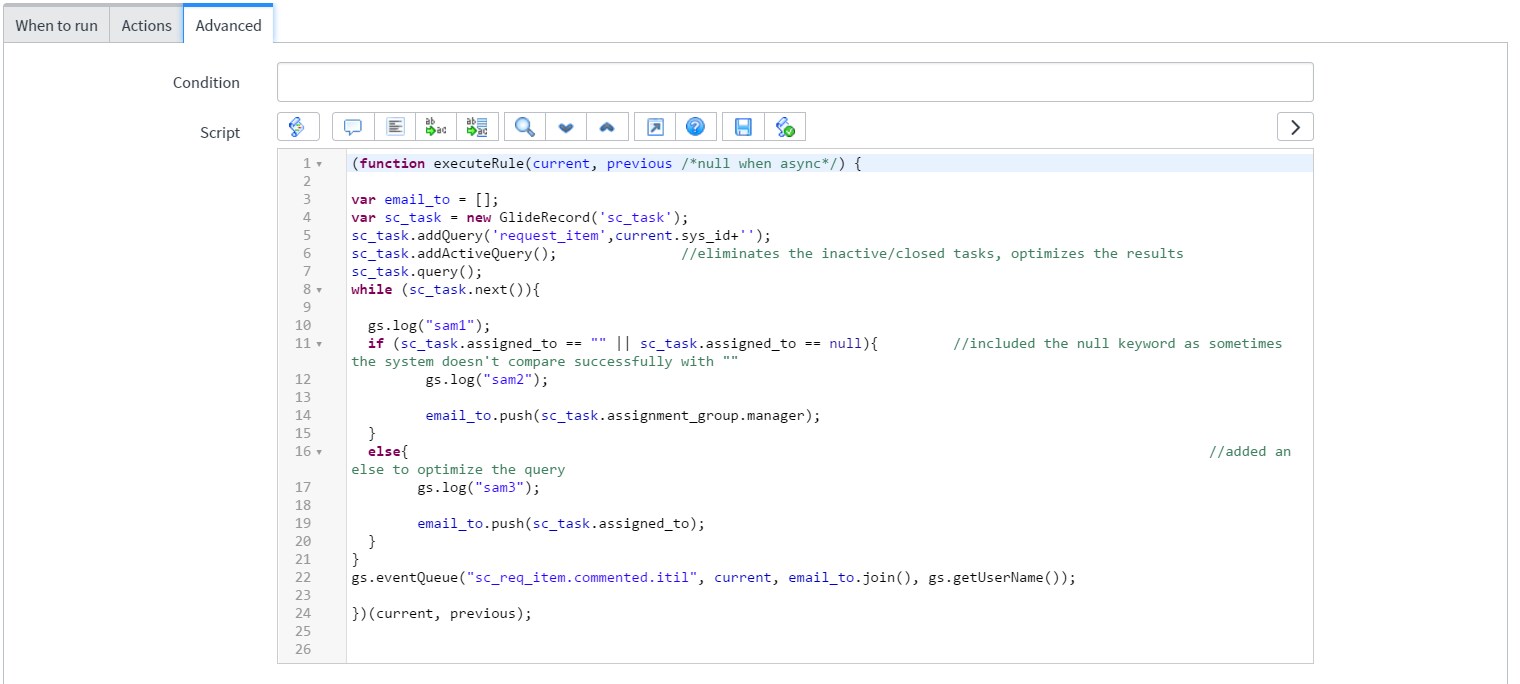

I require that when the additional comments on the sc_req_item change an email notification is sent to the person who is assigned to the task related to that item.   I found an earlier post on here and tried to replicate the business rule and notification, but I'm not getting any email notification firing.   Below is the business rule setup and email notification setup.   Do I need to add somewhere to the notification the business rule that is being used?

This is puzzling, the order of tasks shouldn't make any difference, can you please modify the BR as follows -
function executeRule(current, previous /*null when async*/) {
var email_to = [];
var sc_task = new GlideRecord('sc_task');
sc_task.addQuery('request_item',current.sys_id+'');
sc_task.addActiveQuery();                             //eliminates the inactive/closed tasks, optimizes the results
sc_task.query();
while (sc_task.next()){
  gs.log("sam1");
  if (sc_task.assigned_to == "" || sc_task.assigned_to == null){                 //included the null keyword as sometimes the system doesn't compare successfully with ""
                gs.log("sam2 "+sc_task.assignment_group.manager);
                email_to.push(sc_task.assignment_group.manager+'');
  else{                                                                                                                                                                                                 //added an else to optimize the query
              gs.log("sam3 "+sc_task.assigned_to);
              email_to.push(sc_task.assigned_to+'');
gs.log("sam4 "+email_to);
gs.eventQueue("sc_req_item.commented.itil", current, email_to.join(), gs.getUserName());
})(current, previous);
I've just tweaked the logs and the email_to.push statement.
Please run all the 4 use cases and share the logs/results:
1. both tasks have assigned to
2. both tasks don't have assigned to
3. task 1 has assigned to & task 2 doesn't
4. task 2 has assigned to & task 1 doesn't
