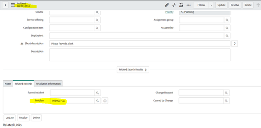

As we know on incident form there is one reference field which reference to problem record. (See Screenshot below)

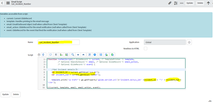

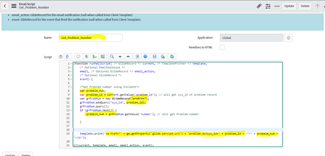

So you need to create two notification email scripts :
1.Get_Problem_Number
2. Get_Incident_Number

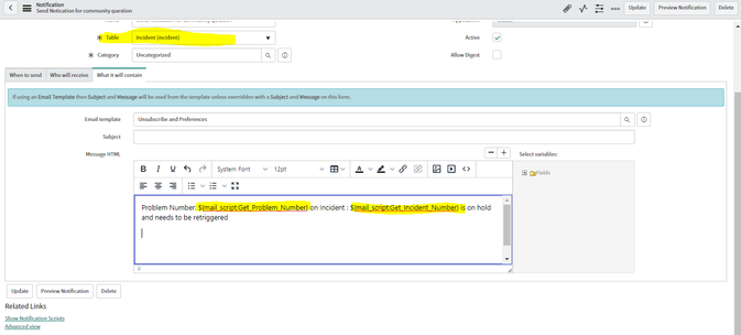

Now need to call these two email script on Email Notification,
When you preview this notification with Incident number below is the end Result :
