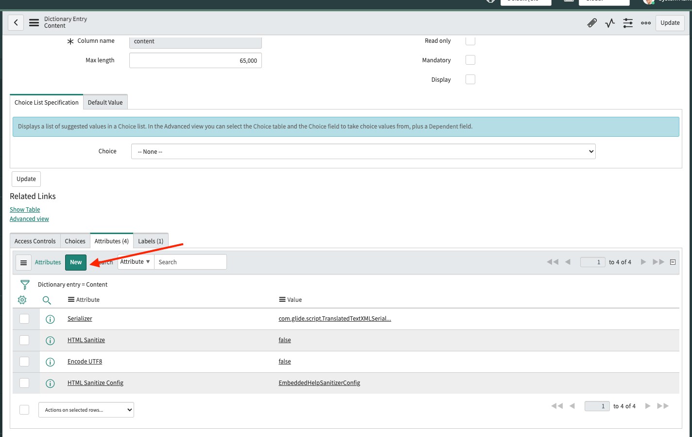

Try this-
Go to the embedded help form—Right-click on the "Content" to pull up the filed context menu. Click on the "Configure Dictionary" option.
When the new form opens up, go to the attributes section and add a new attribute.
You will call it "HTML Sanitize" and set the value to false. This will stop the system from stripping out the code.
Now you can add custom code. For example, I upload a video to the db_video table and add the code to the embedded help.

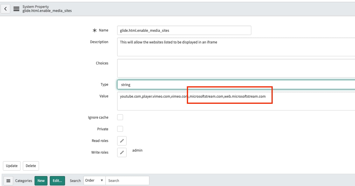

If you are referencing an outside source, you will need to add the link to a system property -
Go to sys_properties.LIST once there search for this system property - "glide.html.enable_media_sites"
I added the Microsoft Stream site as an example.
In the value section, add the following after the last value. In this example, after the "vimeo.com" is the last value. You have to add a "," to separate the site. Once you are done, save.
,microsoftstream.com,web.microsoftstream.com

Amazing, thankyou for the screenshots and step by steps.
I was about to update this post this morning as I also Identified this attribute causing this last night as well
Thanks again
