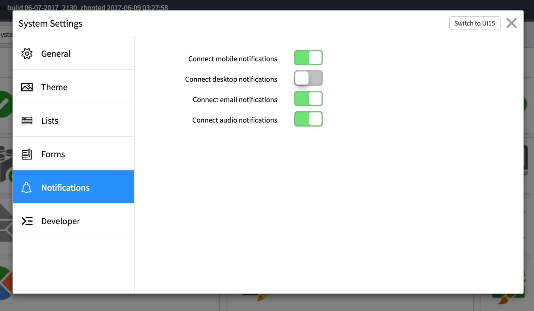

‎06-09-2017 11:37 AM
Hi Antony - what do you mean by "no visual representation'? Just trying to get some clarification on this.
In general, once you enable desktop notifications by going to Settings cog in the upper right corner, all your agents will be receiving desktop notification on every new activity as long as they don't actively look at a chat. Moreover, you can upload MP3 file and enable audio alerts that are triggered by new activity as well.
Also, once agents accept a chat from a queue, unread messages are represented via an unread message count next to a chat.
