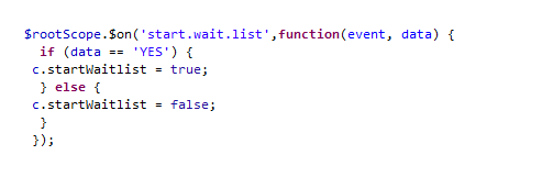

Thank you, Satheesh! That did not produce the expected result...
I have resolved this issue.
1. Removed the one time binding in the HTML template for the submit button
broadcasting widget
HTML
Client Script
Listening widget
HTML
Client Script
This works well now. Thank you!
