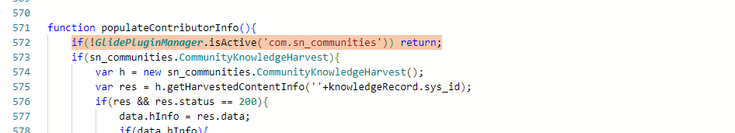

Hi @Sandeep Rajput  I've looked in the Server Side code and it's already there:

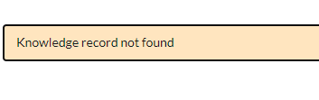

What we also noticed is that if we open any knowledge article from the list of knowledge bases within the knowledge module, the following error appears:
