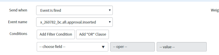

Hello, I am working on an application that has an approval on a table not extended from the task table. I am trying to make an event to activate when this approval is started. This would then activate a notification to send an email notification out to those that need to approve. My problem is that the event and notification isn't firing unless I create it in the global scope, which I cannot do. From what I can tell it seems like it is because of the naming of the event. I can't name it exactly right when it's scoped see first photo for scoped event. Any help to fix this problem would be great.

Thank you for your feedback. I used the event name not the suffix when creating the notification. But as far as calling the event, it should be automatically triggered when the approval starts in the workflow which is why I have the ".approval.inserted" at the end. Unless I understood that incorrectly. It does work that way when the event is in global scope.

Also the only difference between the two is the bc.afi and bc_afi for the name if that helps.
