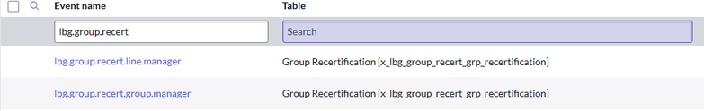

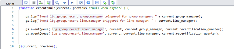

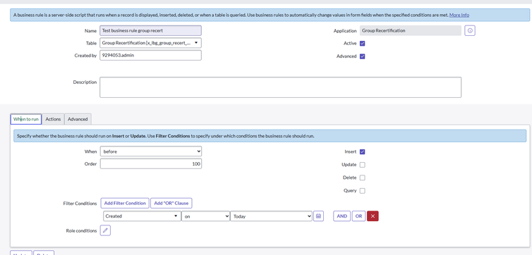

I've created the below business rule where I'm trying to generate two events. I'm wanting it to trigger when records within the 'x_lbg_group_recert_grp_recertification' get created on the current date:
My two events are:

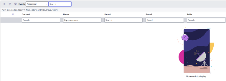

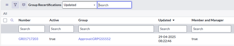

The records are being created via a Scheduled Job. However what I'm finding that even though there are records that are being created today, it's not generating the two events:
So I was just wondering if anyone knows what I'm doing wrong so that I can generate the two events

@matthew_hughes You are checking "Created on Today"  , but in a "before insert in business rule " , the created field is still null(it hasn't been saved yet).
so the condition created on today fails.
so you can use the script instead of filter condition something like this
   var today = new GlideDate();
   var createdDate = current.sys_created_on.getDate();
   if (createdDate == today.getDate()) {
       gs.log("Event 1 triggered for group manager: " + current.group_manager);
       gs.log("Event 2 triggered for line manager: " + current.line_manager);
       gs.eventQueue("lbg.group.recert.group.manager", current, current.group_manager, current.recertification_quarter);
       gs.eventQueue("lbg.group.recert.line.manager", current, current.line_manager, current.recertification_quarter);
})(current, previous)

Created field is updated after the form is submitted, Therefore, you are checking before insert and Created on today would not work. Instead use Flow designer with "Record" created trigger and fire events as below:
