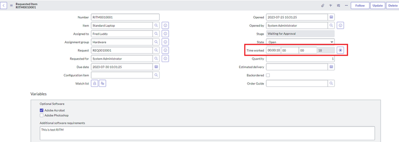

11-06-2023 02:51 AM - edited 11-06-2023 02:54 AM
@SANDEEP28 I agree it is not mandatory to use GlideRecord on the same table. Don't mind that as I was switching the tables to RITM, Task, and Case, just to understand how unique value gets printed in logs.
About the time worked field - Yes, I can see this field in the list view of RITM and on the form where end user works but not on the table (as shown by you).
PFA below:
PS: I am getting the right value in time_worked field of RITM. I want to get the current value of that field in a variable and then process it ahead as per my requirement.
I am stuck to get that current record as everytime I am getting the current record value as CASE sys_id as there exists a relationship between case and RITM. Please check the relationship snip in above discussion.

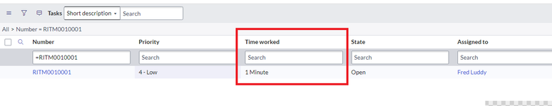

11-04-2023 11:08 PM
@swapnil15 First thing you need to check whether "Time worked" is getting populated for RITM record or not. To capture the time worked value, you need to first add the "Time worked" field on the RITM form. Whenever record is viewed, the timer will start as below and once you save the record, time worked value will get save.
To verify, check if Time worked value populating from list view.
Once value is populated, your business rule will work. Refer below doc to know more about "Time worked" field.
11-06-2023 02:09 AM - edited 11-06-2023 02:11 AM
Hello Sandeep,
Thanks for your response.
Yes, I have checked the time worked field is populated for RITM and it captures the time properly as per the user spends time on RITM. Can you tell me how I can fetch the value of time_worked field by using GlideRecord. I am unaware of the filter to add in addQuery condition after gliding the sc_req_item table. I used sys_id is current sys_id but it didn't helped as the updates on RITM are been pushed to CASE hence the script is always fetching the current thread as CASE but not RITM.
