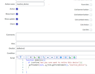

We have created a button "inactive aset" in "alm_hardware" table and confrmation
pop up also with Ok and  cancel.  its working fine.

Try this
function doRetire(){
	if(confirm('Are you sure?'))
		gsftSubmit(null, g_form.getFormElement(), 'inactive_device');
if(typeof window == 'undefined')
retireDevice();
function retireDevice(){
	current.setValue('install_status', 7);
	current.update();

I have tried that but no luck i want to upfate fields on "alm_asset" like below
install_status
Retired -> ‘7’
can you please help me on the script.
Try this
retireDevice();
	current.update();
