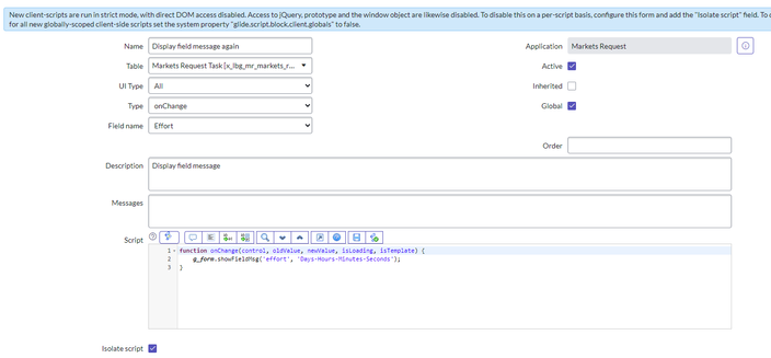

@Ankur Bawiskar In fact, it just works with the onChange client script without the needs for onload client script:
Could I just use the one client script or would I need to use both?
10-26-2023 06:55 AM
yes remove onLoad in that case

Hi @matthew_hughes To achieve you can use onChange client script and select the action variable and comment out the return so that the script will run on both onLoad and Onchage and write your showFieldMessage method.
