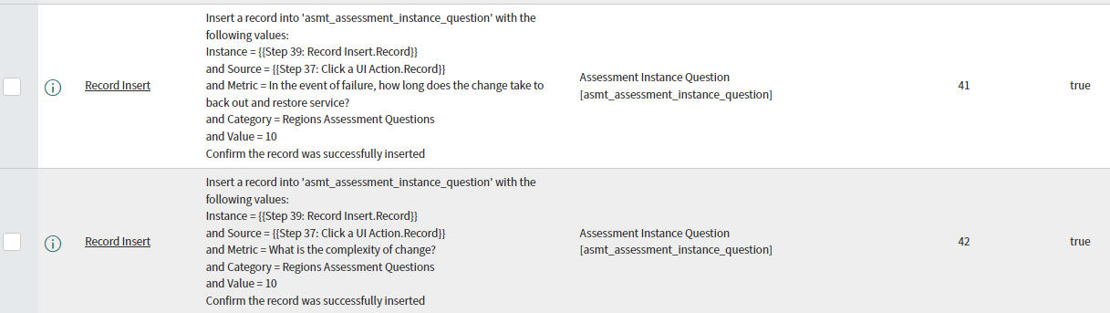

I am trying to Test Change forms using ATF where I was Struck at a point to Fill the Risk Assessment. So once a user fills that risk assessment and submits the Risk value is populated.
Approaches I Tried as of now:
1. Using the Custom UI  step in ATF.
2. Directly inserting the record into metric result on that particular Change Form.
Share me your thoughts, which will help me.

I have done this.
Suman P.
Hi
Can u Guide me with the steps to fill the Risk Assessment?
If you can post the entire steps in sequence It will me easy to understand
Thank you in advance
Midilesh
To do this you need to be an admin. step 38 is admin.
first you need to create assessment instance. followed by questions.
