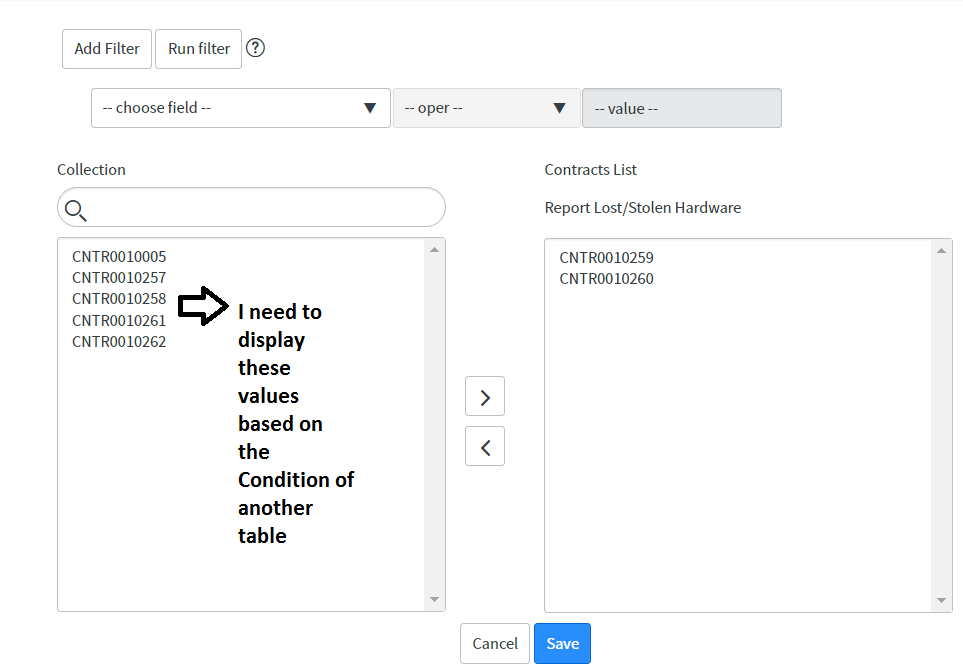

I have a "Slush Bucket" with few records inside it, Please see the screen shot below : -
The Values inside the Slush Bucket are comming from say "Contratcs" table. I want to display those contracts inside the slush bucket which has the company same as in SC_Cat_Item. Can you please suggest me which approach i can take to achive this functionlity.

Hi Sunil,
You can accomplish this by creating a "reference qualifier" for the sys_dictionary record of the slush bucket. Please refer to the Reference qualifiers documentation.

Thanks for the Reply,
In My scenario I need to Modify the "Slush Bucket" from sys_m2m_template.do form, I tried to apply "Reference Qualifiers" but no luck can you assist me on this Please.

Hi Sunil,
Please refer to the following links:
Changing the Filter of a List Collector Variable via Client Script
Pre-filter Slushbucket
