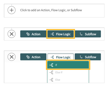

To add If flow logic to a flow:
  1. Click the Select to add an Action, Flow Logic, or Subflow link.
  2. Click the Flow Logic button.
  3. Select the If menu item.
    The steps to add If flow logic to a flow.

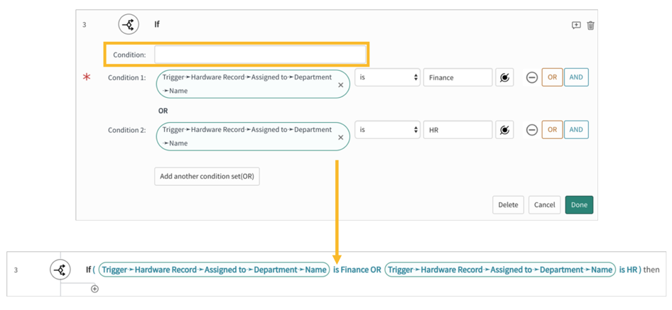

Configure the If flow logic with a friendly, readable Condition label and set the conditions.
If no Condition label is set, Flow Designer constructs a branch description using the conditions:
If flow logic configuration without a Condition Label displays the conditions for the if statement.

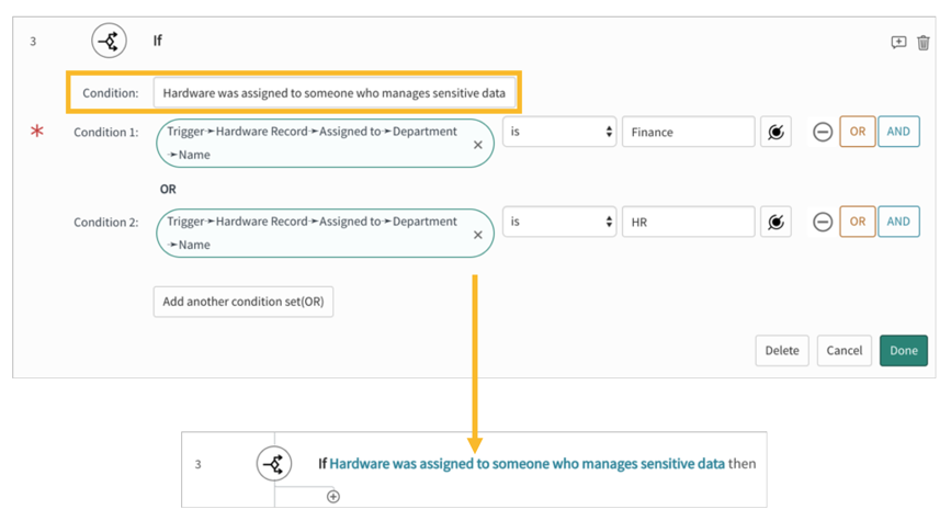

If the Condition label has a value, Flow Designer uses the Condition label for the branch description:
If flow logic configuration with a Condition Label displays a user friendly If statement.

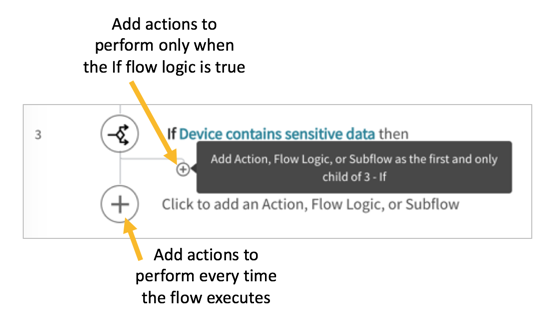

To add actions or additional flow logic to an If branch, click the Add an Action or Flow Logic button for the branch. Configure the action.
The plus button for the If branch adds conditional actions.
