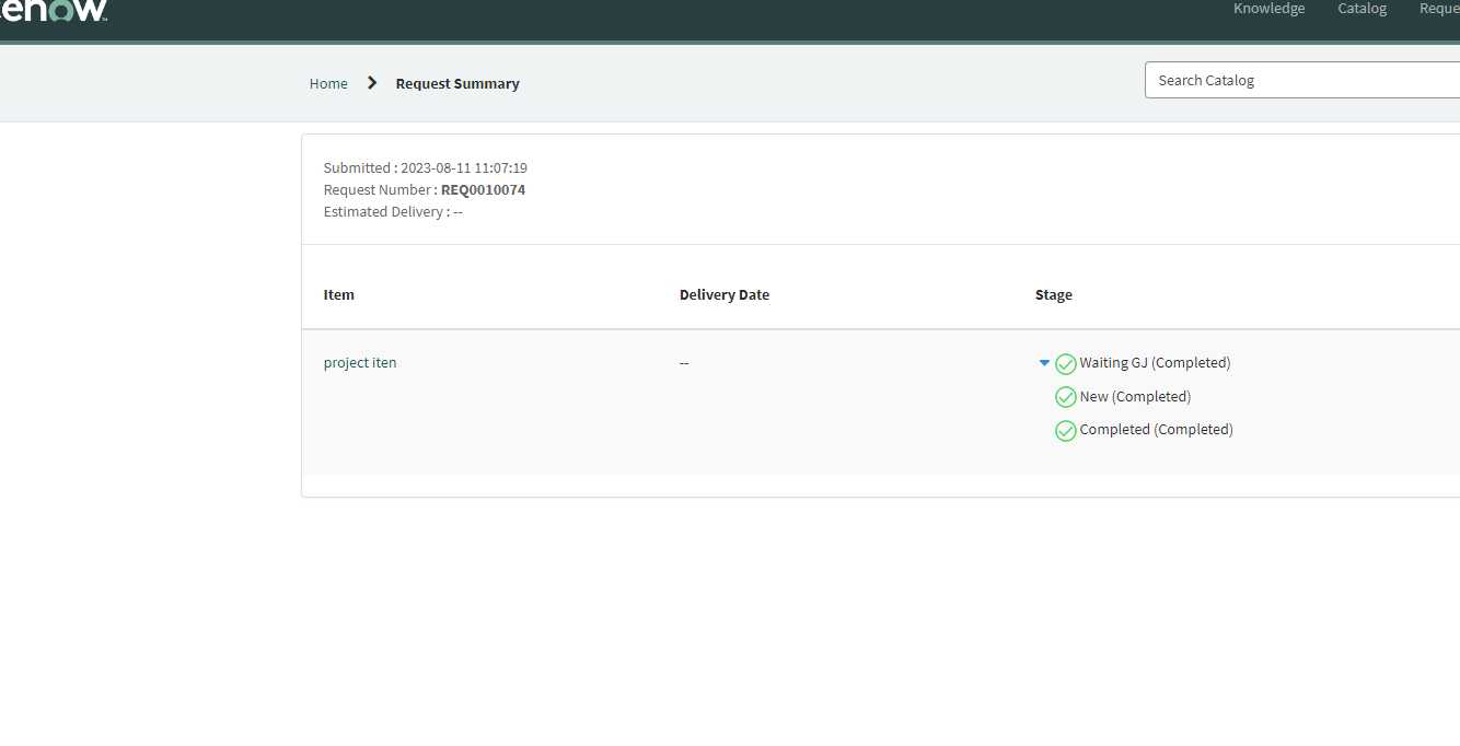

I'm new to flow designer and am having difficulty setting the stages based on states. Initially I had both request and request item set to update but removed request to simplify things. If possible I would like to make sure both are the same. The problem is when I run a "test" the states /stages look like they are all processing correctly. However when I submit an actual request, all of the stages are getting completed. I've simplified this by rooming all of the "ifs" but one and it is still happening. What I am trying to acheive is to have an inital stage and state set. Then if the state changes the stage should also.
Attached are some screenshots to help explain.

Flow must wait at certain stages for that stage to reflect. For eg: approval.
Your flow is not waiting anywhere to reflect the stage. It is traversing through all the stages, but as it is not waiting at any stage, you are unable to see the stage value.
Secondly.
Stage and States doesn't have tight coupling connection.
Stages are mainly meant for the users and state is more internal, mainly for reporting purpose. You can set or change state value inside the flow, but there is no synch between them, until you build one.
