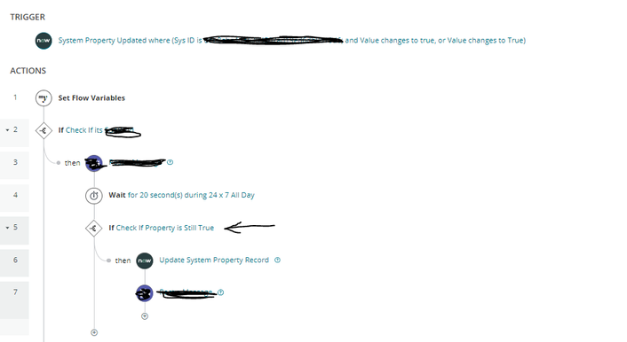

I created a flow designer that triggers when a value of T/F property changes to true , It doesn't trigger when I update property to true.

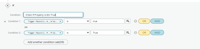

It works when I click on test and use the same property as example. Later in one of the steps , there is a if statement to validate if its true . that steps always fails although its true.
can this be triggered/validated on a system property ?

Please define a flow variable of type true/false and set the flow variable using the property value then use flow
variable for if condition

I think you are using the trigger data .
Trigger data will not change after the flow starts running althrough the value changes in the table..
You need to call a record search to get the newest value and use the value instead of the trigger data in step5.

Flow designer doesn't work well with True/False estimating。。。
See this ~~
https://www.servicenow.com/community/developer-forum/flow-designer-if-condition-for-confidence-to-pr...
Using other values instead of True/False may be a safe way...
