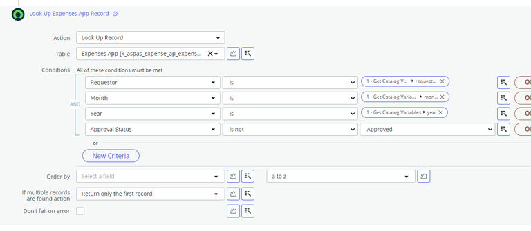

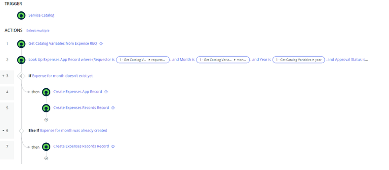

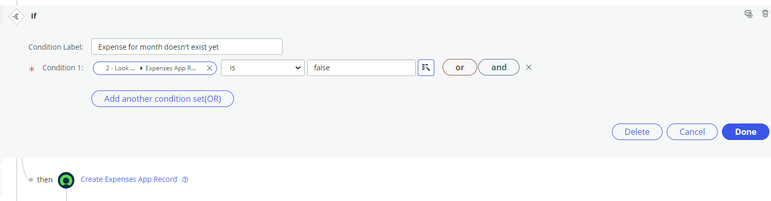

Anyone knows if it is possible to check if a record with particular parameters already exists?
In this flow i want to check if it already exists, if no to create one or if yes to create a record on another table.
