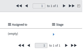

Hi Allen,
So the workflow is blank as this is running using a flow. See below:
Should this be using a flow and a workflow?
