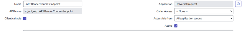

Trying to populate a form drop-down on portal, using a catalog client script/ script include to return JSON from an internal REST message.  However, I can't get it to display on form load.
REST Config:
SI:
var LARFBannerCoursesEndpoint = Class.create();
LARFBannerCoursesEndpoint.prototype = Object.create(global.AbstractAjaxProcessor.prototype);
LARFBannerCoursesEndpoint.prototype.process = function() {
    var restEndpoint = 'LARF Banner Courses';
    gs.log('Rest endpoint:', restEndpoint);
    var response = new sn_ws.RESTMessageV2().setEndpoint(restEndpoint).setHttpMethod('GET').execute();
    gs.log('Response:', response);
    if (response !== null) {
        var responseBody = response.getBody();
        gs.log('Response body:', responseBody);
        try {
            var courses = JSON.parse(responseBody);
            gs.log('Parsed response:', courses);
            return courses;
        } catch (error) {
            gs.log('Error parsing response:', error);
            return [];
    } else {
        gs.log('No response from server');
        return [];
CS:
function onLoad() {
    var ga = new GlideAjax('LARFBannerCoursesEndpoint');
    ga.addParam('sysparm_name', 'process');
    ga.getXMLAnswer(function(answer) {
        if (answer) {
            var courses = JSON.parse(answer);
            g_form.clearOptions('course_information');
            for (var i = 0; i < courses.length; i++) {
                var course = courses[i];
                g_form.addOption('course_information', course.label, course.value);
        } else {
            g_form.showErrorBox('course_information', 'Error: no data returned from server');
Form onLoad:
Medi C
