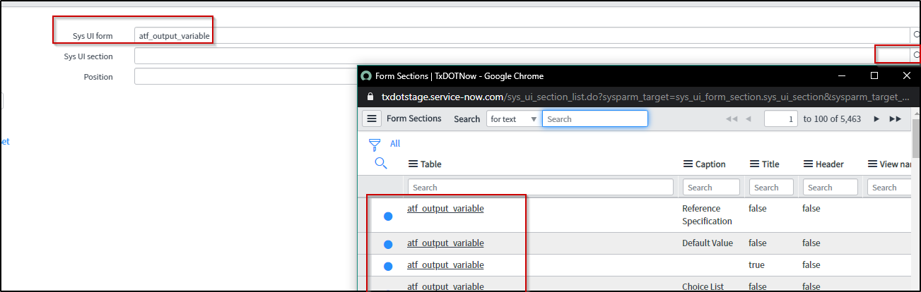

So, I had this issue after our upgrade to Orlando this week, only we discovered it on the atf_output_variable form. I checked to make sure none of our 5 instances was actually working properly. No dice. I went to my personal developer instance, and looked at the Forms>atf_output_variable>advanced record.
- I exported all six form sections as .xml files (sys_ui_section) (make a dedicated folder to store these in - you'll be happy you did)
- For each form section, I exported all of the element files (sys_ui_element).
- I exported one type Reference record from my instance as an .xml file - save this file for the end of the process.
- Imported all of them except #3 to the 2 correct tables, sys_ui_section first and then sys_ui_element.
- Navigate to Forms>atf_output_variable>advanced - you have to manually add the form sections back in by searching for them. On the Form Sections, click "New", then use the search on the Sys UI Section field to find the sections you imported via xml earlier.
6. When you go to import the .xml for the output variable record in step 3 above, you will get an error about permission denied. Do it anyway, because for whatever reason, this is where the magic happens.
7. Navigate to atf_variable_output.do and confirm you can get your form to work.
