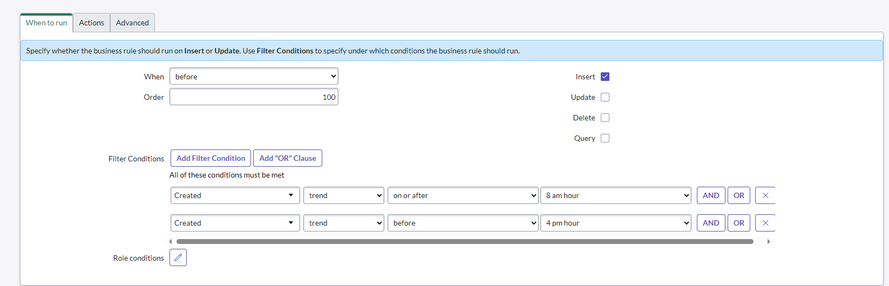

I'm wanting to the update the following field on a request based on the time a request is created:

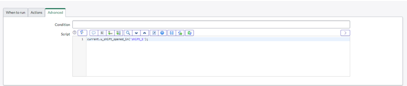

I'm wanting to update the value via the following Business Rule:
However, when I create a new request and save it, I get the following error message and the field is not populating:
I was just wondering if somebody could explain why the error message is occurring and what I need to do prevent it from re-occurring.

Hi @matthew_hughes,
That is not the way you fill a field in a script.
You should use either one of below lines
current.field_name = 'new_value';
current.setValue('field_name', 'new_value');
Is this always going to be a hardcoded value?
Then you shouldn't need to use a script at all, but just select the field and value in the Actions tab of the Business Rule.

I tried that as well, but the same error was occurring.
I doubt it is coming from the Business Rule.
If you remove the read only of the field, and set the value manually, does it still happen?
