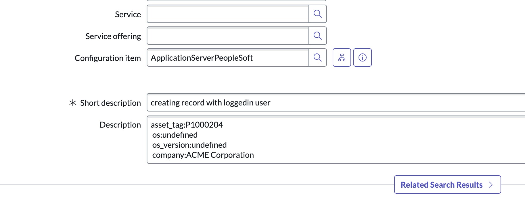

I'm trying to implement a GlideAjax scenario where, whenever a Server Class CI is selected in the Configuration Item field on the Incident form, the Description field should be auto-populated with details from the selected CI. The details include:
  • Asset Tag
  • Company
  • Operating System
  • OS Version
I have written the necessary client and server-side code using GlideAjax, and the functionality is working partially. The Asset Tag and Company are populating correctly, but the Operating System and OS Version are returning as undefined.
I'm attaching the screenshots of the code and form behavior for reference.
Screenshot 2025-04-25 at 12.27.29.pngScreenshot 2025-04-25 at 12.31.28.pngScreenshot 2025-04-25 at 12.40.30.png
Could someone help me understand why OS and OS Version are not being retrieved, and how I can fix it?

OS and OS version belong to the 'cmdb_ci_server' table. You are querying the 'cmdb_ci' table, where those fields are not present.
So, modify your code to Glide through the cmdb_ci_server table. PFB the test run results from my pdi.

Thanks a lot! I updated by querying cmdb_ci_server, now I’m able to fetch the OS and OS Version fields correctly.
