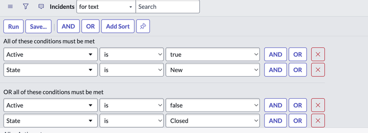

Build the query in a list view filter using the correct combination of ANDs and ORs that meet this criteria. You can then right-click on the last breadcrumb and copy query to see the correct encoded query. In an out of box example (active=true and state=New) or (active=false and state=Closed) the manual filter looks like this:
and the resulting encoded query is:
active=true^state=1^NQactive=false^state=7
So it looks like your example would be:
gr.addEncodedQuery('u_year=2023^u_month>=3^NQu_year=2024^u_month<=2'); // Die Bedingungen korrekt gruppiert
