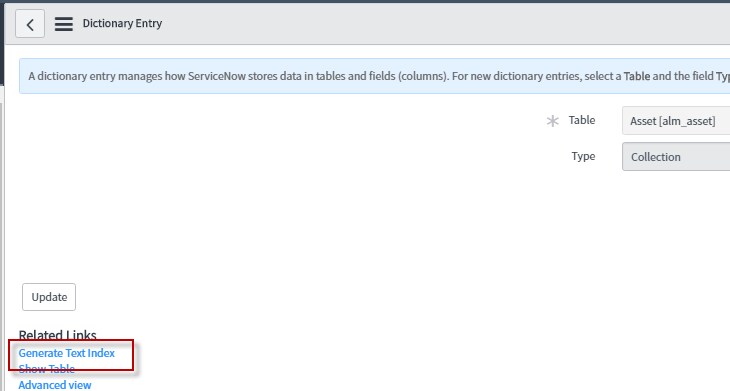

Hi Lars
Thanks for the reply, that makes sense to me, however the Text index field is hidden for some reason.
So, I found a UI Policy that was hiding the field unless the type was 'collection'. I made that inactive and the field has appeared.
Now I cant see the related link even though the UI action says to show it
Any idea why the related link would not be showing?
Chris
Hi Lars
I think I got it.
I had to remove 'current.internal_type == 'collection' && ' from the condition and now I can see the Related Link
How long after clicking regenerate text index before I should get a result on the search or is it dependent on the size of the database?
