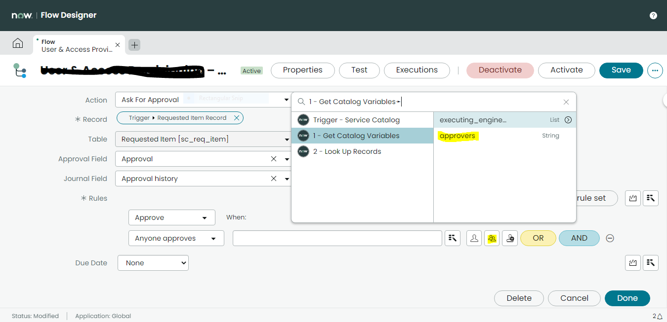

I have a requirement to set Group Approval on the RITM for a Catalog Item.
So, there is a Single Line Text type variable - 'Approvers'. This field has the name of the Group that should be set as the Approval on the RITM.
For the Catalog Item, we are using a Flow Designer. In the 'Ask for Approval' action I do not any option to select dynamic values (Group name from the variable 'Approvers'). Below is the screenshot -

Instead of making a single line text field make that variable a reference type to (sys_user_group) table i.e. the Group table, then you would be able to use it as a data pill picker for approval in flow designer

‎12-30-2021 08:48 PM
Thanks for the suggestion Sourav. It worked!

Please follow the steps below to achieve your requirement:
1) You need to use a Script here to achieve the same. Use the Action Named as "Create Record" and then use the script below:
var getApproverName = fd_data._1__get_catalog_variables.VARIABLENAME.toString(); // Replace VARIABLENAME with your Variable here
var gr = new GlideRecord('sys_user_group');
gr.addQuery('name',getApproverName);
gr.query();
if(gr.query()){
return gr.sys_id;
Also suggestion would be to have a Reference field on your form, reason being as there might be chances that there are duplicate groups and it will be difficult to handle those scenario and with a reference variable you can directly dot walk and generate an Group Approval without any script.
