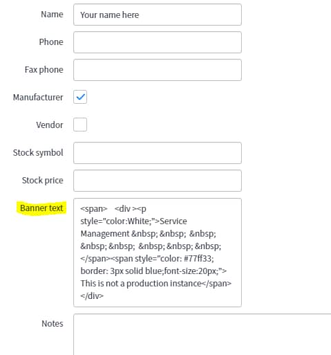

‎08-01-2017 02:57 AM
I have done something similar to what you are asking.
For this I have added my required text and additional styles in My company from navigator.
Follow the below steps:
System properties-->My Company
THEN ADD THE CODE AS BELOW
P.S: Usually the Banner text field will not be seen on the form, so please add that from the form layout if not visible. And the size of the field is limited. If you want to add large text/more html code to your text, increase the size of the fied from configure dictionary.
Sowmya
