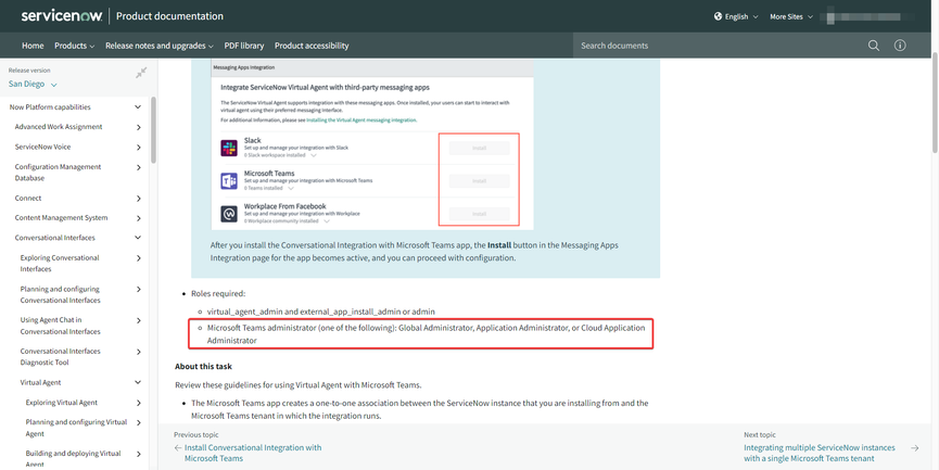

Thanks. But I am the only one user in the pdi, also pdi is new. I found this link where I read I need admin access to MS Teams (and I haven't):
https://docs.servicenow.com/bundle/sandiego-servicenow-platform/page/administer/virtual-agent/task/c...
