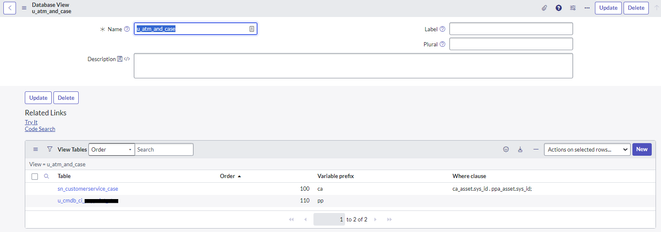

I'm trying to create a database view to link a custom cmdb table and the case table.
When I add the cmdb table to the database view and click on 'try me' the table shows no records.
The purpose of this database view is to create a report which can look at an asset and see if there are any cases related to that asset.

The where clause doesn't support the dot walking. You have to think about the correct condition
Something unique on the both table and write the query like below
here com is company and checking the user's company and give the correct data.
Both field should are referring to the same sys_id.

Hi Alex,
Please check the where clause you written the ppa it must be pp

Hi Siddhesh,
I have made that change, must have been a typo, but unfortunately I'm still not seeing any records.

Hi @Alex319 ,
Your "where clause" is writting wrongly. You have written "ca_asset_sys_id.ppa_asset_sys_id", but it think it should have been "ca_asset_sys_id = pp_asset_sys_id". Please also remember of one of the tables should be a left join or not.

Hi Anders, yeah sorry Siddhesh pointed out that typo too. unfortunately after updating I still have the same issue.
