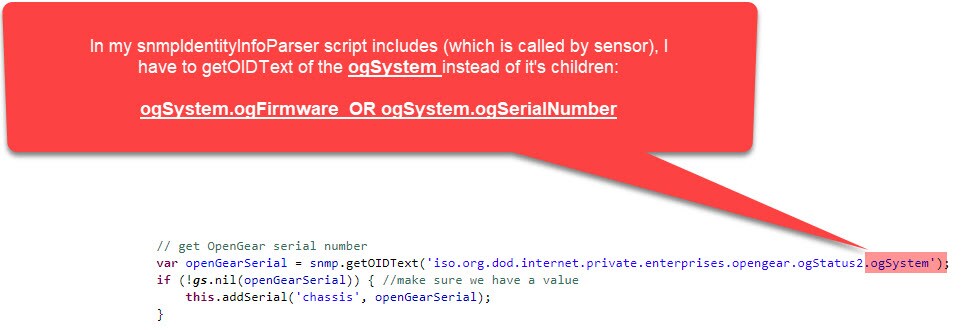

  1. I had to use the ogFirmware oid in the SNMP field (walk) that I had to use to get the ogSerialNumber value back in the SNMP Identity payload.
  2. The ogSerialNumber is not represented in a node of the input xml, the value is returned on the parent node (ogSystem).
  3. In the snmpIdentityInfoParser, which is called by sensor, I had to use the ogSystem (the parent oid) to write the value of the serial number.
