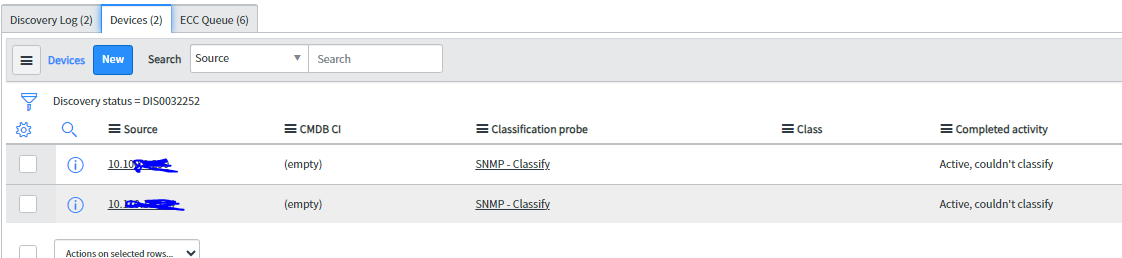

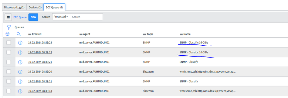

Trying to discover CISCO network devices using SNMP and facing the error > Active Couldnt Classify..
1. My creds are working.
2. Ports are Opened, (Mid server acl is added to network) , Discovery was working earlier.
3. OIDs are added already, but unable to receive sysObjectID in payload.
4. Discovery returns no error except > active couldnt classify.

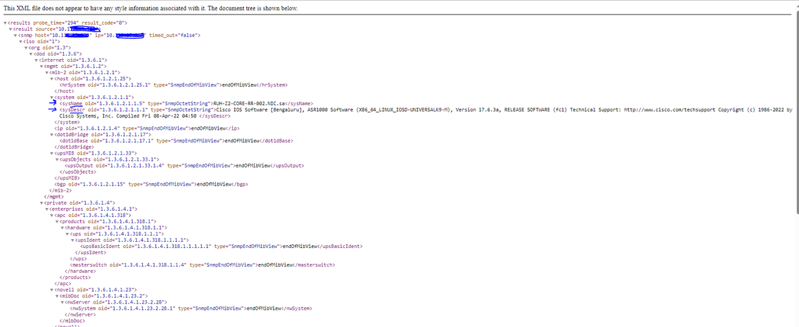

Without sysObjectID it cannot classify. Try create a new snmp test probe with the OID 1.3.6.1.2.1.1.2. You will have 'test' related link on the probe record with that you can run it against the target device if that was not returning any value then you need to contact the team who is responsible for the device.
