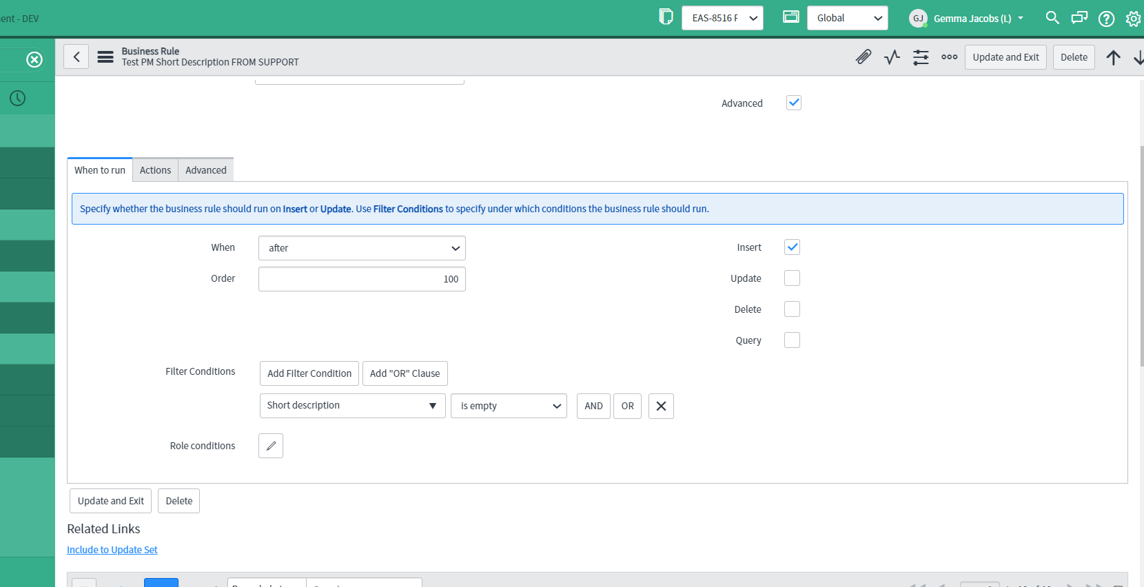

Yes @sushantmalsure I did change the condition. Attached is the br for the request short description and br for the request item description. I've tried so many different variations with the script etc. I really appreciate all your help! Do I need 4 business rules to achieve the following:

I think you are complicating the things.
You just need 1 after insert  business rule on sc_req_item table.
Deactivate the BR which you have on sc_request table.
Now the one you have on sc_req_item table remove the filter condition which you have added as (short description is empty) , add nothing in filter condition.
Finally in script I see you commented current.update() , uncomment that!
So the only BR on sc_req_item and following is updated script:
var gr_req = new GlideRecord('sc_request');
gr_req.addQuery('sys_id',current.request);
gr_req.query();
if(gr_req.next()){
gr_req.short_description = current.variables.request_name;
gr_req.description = current.cat_item.name;
gr_req.update();
current.short_description = current.variables.request_name; // this part is for setting short desc of RITM
current.description = current.cat_item.name;
current.update();
Note: do check if request_name is correct name for variable Request Name.
