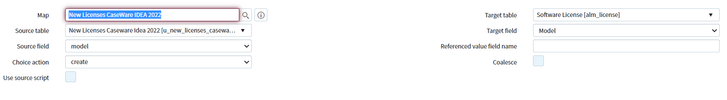

I am experiencing an issue with a transformation map I created. My issue is that one of the reference fields mapped in the transformation map is not picked up properly.
I logged a ticket with ServiceNow and they confirm that the transformation map is configured properly. They suggested using a script in the field mapping to make sure the proper field is picked up.
I told them that I don't have any code experience, but they can't provide any suggestions when it comes to scripting because it means "product customization" and, as a consequence, "not supported.
This is how the field map looks like.
How do I achieve the same result with a scrip? Is the following one correct?

11-25-2022 04:39 AM
To avoid creation of new record, you will need to have coalesce field on transform map.
e.g. you can make your model field as coalesce field (depends on your requirement ), which will update existing record if model name matches. to avoid creation of new record, you need to select choice action as ignore ( refer below image to perform this action)
