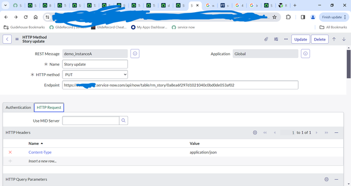

Hi I'm testing put method in rest message but its not updating the record. I attached the screenshot

Do you have access to the target instance? If yes, then please test in rest api explorer once and if everything is same then it's just an access issue for the user which you are using. Some ACL's must be preventing from updation or the user is not having the required role to update the record.

May I know, what error code and response you are getting after hitting PUT API?
Thank You.
Shubham Gupta
Actually the value which I'm updating is TEST@ but it's not updating.
The response which comes contains the existing value only 123446
@Bruce lee
But you are updating the field - u_short_description and the response is returning short_description
