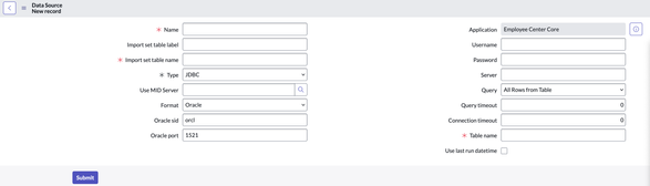

Depending how you are connecting to Kafka, tie it to a MID Server
If you can connect directly to the Kafka database below is an example Data Source.
Notice the "Type" and "Use MID Server" fields
