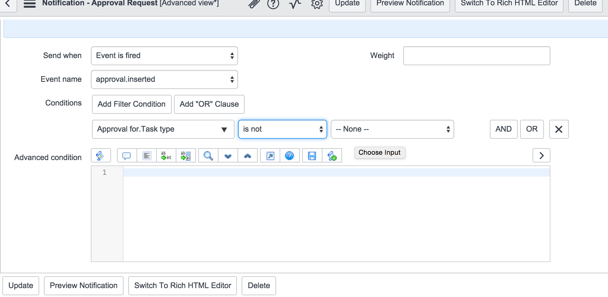

You can modify the "Approval request" OOTB notification condition so that it doesn't trigger for your custom table.
Go to the condition field and click on show related field->Now Click on Approval for->Task fields->Now select the field task type
Hence the condition will be Approval for.task type is not "your table name".
Then you can mimic the same notification and create the one with your own template which will have the condition to trigger only for your custom table only.
I hope this helps

Hi Todd,
I hope this helps
Pradeep,
This looks like the answer I'm looking for. I will verify this approach tonight and mark as the correct answer. I'm very grateful for your time and expertise.
Todd
