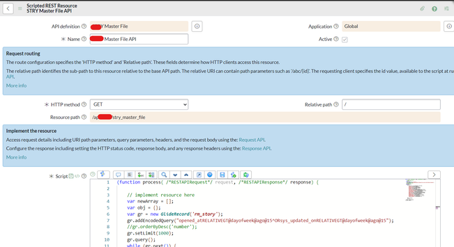

AniketC85155510
Hello @Abhijit Das7 ,
Please see the below code and from that you can take the reference to modify it further as per your requirement.
(function process( /*RESTAPIRequest*/ request, /*RESTAPIResponse*/ response) {
    // implement resource here
    var newArray = [];
    var obj = {};
    var gr = new GlideRecord('rm_story');
    gr.addEncodedQuery("opened_atRELATIVEGT@dayofweek@ago@15^ORsys_updated_onRELATIVEGT@dayofweek@ago@15");
    //gr.orderByDesc('number');
    gr.setLimit(1000);
    gr.query();
    while (gr.next()) {
        obj = {
            'Project_ID': gr.project.number.toString(),
            'Project_Description': gr.project.short_description.toString(),
            'Project_State': gr.project.state.getDisplayValue(),
            'Project_End_User_Description': gr.project.description.toString(),
            'Project_Start_Date': gr.project.work_start.toString(),
            'Project_End_Date': gr.project.work_end.toString(),
            'Capitalization_Flag': gr.u_finance_capitalization.toString(),
            'Story_Short_Description': gr.short_description.toString(),
            'Component_Category': gr.u_component.title,
            'Component_Subcategory': gr.u_sub_component.title
        newArray.push(obj);
        obj = {};
    response.setBody(newArray);
})(request, response);

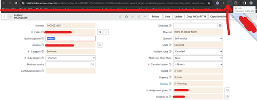

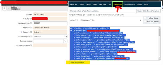

Also to get all the field values from the table you can do simple thing if you have SN utils chrome extension then open any record from your desired table from which you want to get the field values e.g incident then click on the SN utils extension logo on the browser and then go to the glide record tab and you will get to see all the field names at one place then you can add then in the array like I shown above in the sample script
