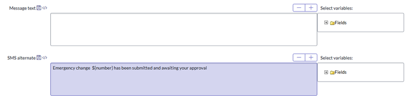

What I've done so far is created an event in the event registry, and replaced the notification activity with a "create event" activity. I then created a notification that fires when the event is triggered. I went to my user record and validated that the notification shows up under the "Notification Messages" related list and is set to go to my mobile device. However, when I execute the workflow and validate that the event was triggered (in the event log), I'm not seeing the SMS in the email logs. I think the disconnect is that even though I have the notification message setup to go to my mobile device the notification itself doesn't have any recipients. This is because adding recipients triggers an email to the users email address, and not to their SMS device.
This is what my notification looks like:

After some additional testing, it appears that the SMS message won't send unless you also have an email template with data in the "Message HTML" field, or the "Message HTML" field is filled out directly in the notification record.
This doesn't work for our scenario, because we are attempting to send an SMS message when approval is requested on an emergency change, and once that change is approved. Because notifications are already setup based on the approval being inserted, this would result in duplicate notifications. At least for the first one.

Have you checked the SMS Alternate box ?

Yes, the SMS alternate field is populated.

If I add text to the Message HTML field, it does send both an email and a text message. But in this case, a different email notification for this event is already being sent, because an approval is being inserted. So ideally I'd only want to send an SMS.
