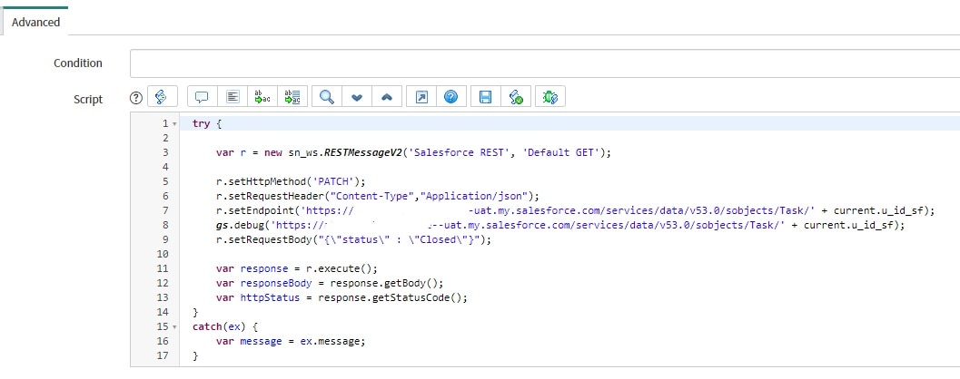

Our code:
try {
var r = new sn_ws.RESTMessageV2('Salesforce REST', 'Default GET');
r.setHttpMethod('PATCH');
r.setRequestHeader("Content-Type","Application/json");
r.setEndpoint('Salesforce link' + current.u_id_sf);
r.setRequestBody("{\"status\" : \"Closed\"}");
var response = r.execute();
var responseBody = response.getBody();
var httpStatus = response.getStatusCode();
catch(ex) {
var message = ex.message;

try {
var tokenRequest =new GlideOAuthClientRequest();
tokenRequest.setGrantType("password");
tokenRequest.setUserName("User");
tokenRequest.setPassword("Pass");
tokenRequest.setScope(null);
var oAuthClient =new GlideOAuthClient();
var tokenResponse = oAuthClient.requestToken("TestClient", tokenRequest);
r.setRequestHeader("Authorization", "OAuth2 " + tokenResponse);
r.setAuthenticationProfile("Salesforce UAT default_profile");
r.setEndpoint('https:[SalesforceURL]/services/data/v53.0/sobjects/Task/' + current.u_id_sf);
gs.debug('https://[SalesforceURL]/services/data/v53.0/sobjects/Task/' + current.u_id_sf);
catch(ex) {
Could you provide any suggestions with this error?
Thank you Ravy.
