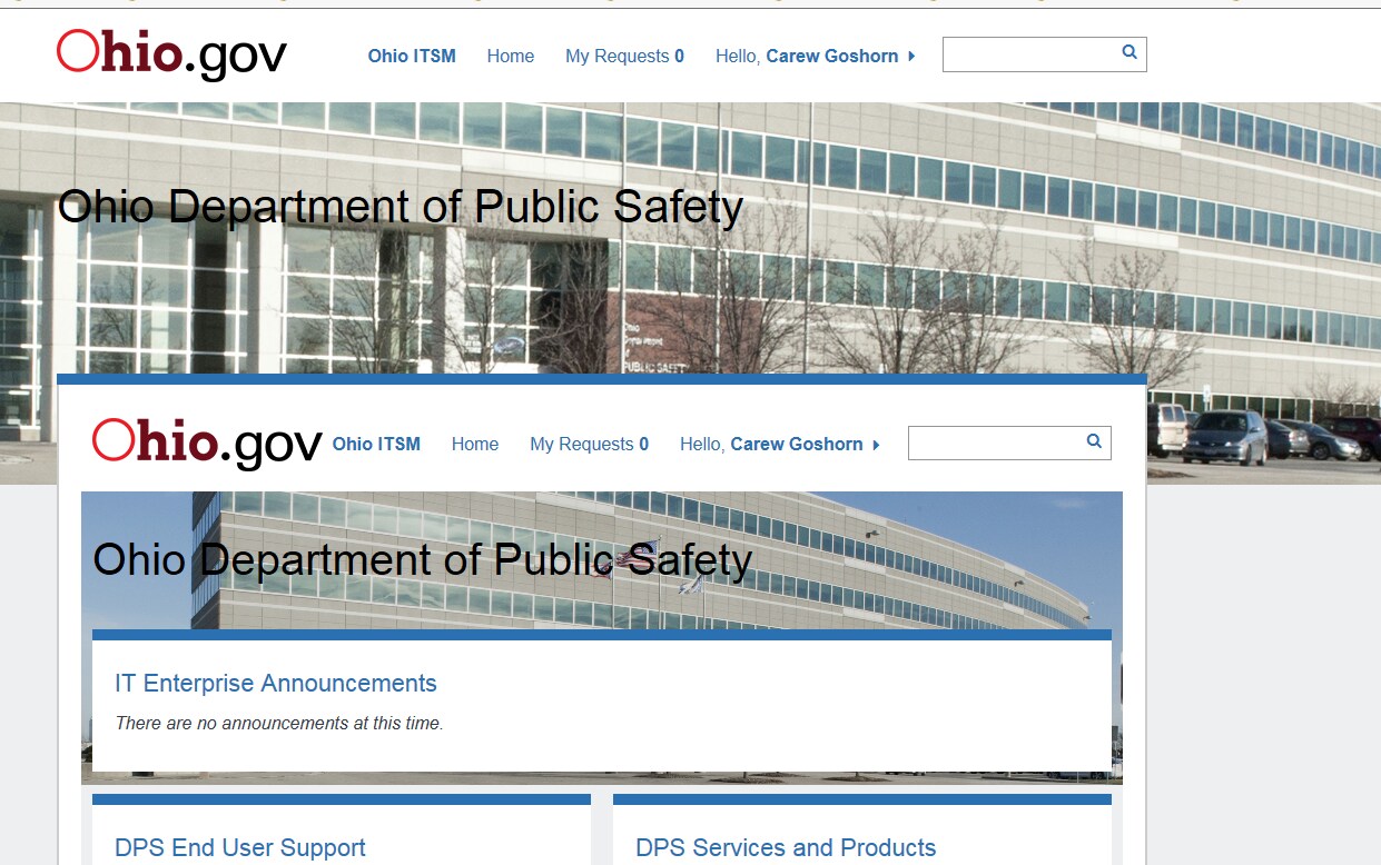

What I would to do on the Portal is to refresh the Portal's webpage when a user click the "Cancel" button in a dialog box.
The reason I would like to do this refresh is remove a partially loaded form which is overlaying on the Portal's web page when the user clicks the "Cancel" button on the dialog box. See below for My Portal's Page partially loaded form, Please not that when the user click's "Okay" on the dialog box the form fully loads.
My Portal's Page
When the user clicks "Cancel" on dialog box, the condition if(con==false) is met (see code below under item JavaScript). The code "window.location='home.do'. is executed. When this statement is executed I get a Portal window within the Portal's web page. This Portal window is the same web page as the Portal's web page. This didn't solve my problem since it not only creates a new tab in the browser, but it did not a refresh of the original Portal web page. See below for My Portal's Page.
My Portal's Page
