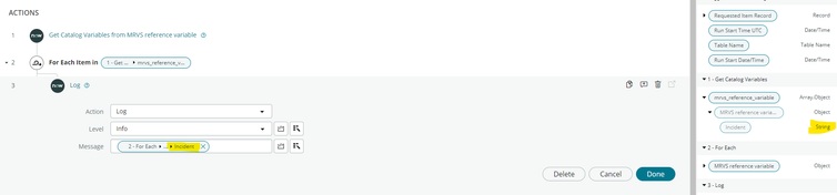

Unfortunately, in the multirow variable set ServiceNow only stores the sys id of the referenced record and not the record itself. Therefore, if you directly drag and drop it (in my case I chose a referenced incident) it will only provide you the sys id.
Logging message in this case: 57af7aec73d423002728660c4cf6a71c

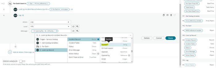

To access the referenced incident record you will have to use a “Lookup record” step where you search in the incident table for the sys id from the multirow variable set as shown in the below screenshot.
Then in the following step, you can access the entire incident record with all its field. For example you can now access and log the incident number which is the default display value of an incident record. However you can access any other fields as well.
Logging message in this case: INC0009009
