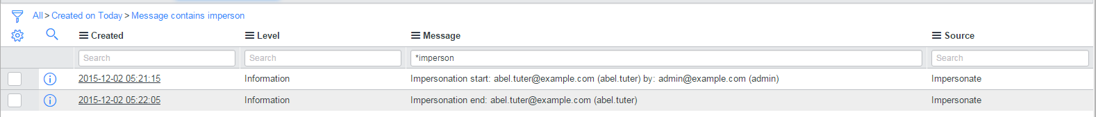

Mike Allen
Impersonations are kept in the logs.   Is there a specific reason you need it?
