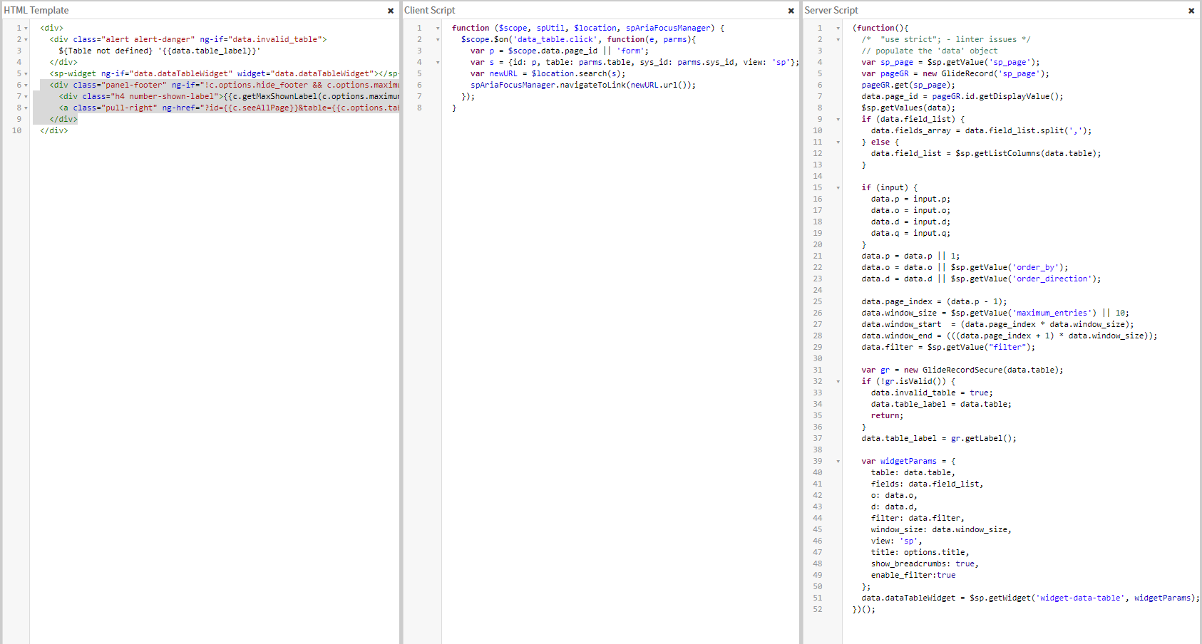

So I am a little new to this but this is what I have so far. I tried adding it to the 'data table filter' widget I created but nothing shows, so I'm pretty sure I am missing some parts to this. Would I have to clone the OOB 'Data Table' widget instead and adjust from there? Also what other parts from the Simple List widget should I get on the scrips to get it to work. I feel as if I am overlooking something simple.
thanks,
Thomas
