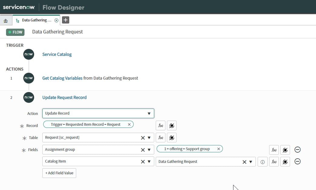

Checking out Flow in Flow Designer the only fields we update are the following:
The Catalog Item is a custom field, but outside of that we are not doing anything crazy. Do you think it could be just the fact that we're updating the request record?
